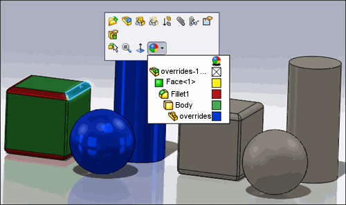

When you apply appearances to models, the following hierarchy prevails:
Component appearance
(assemblies only) overrides face appearance.
Face appearance overrides
feature appearance.
Feature appearance
overrides body appearance.
Body appearance overrides
part appearance.
You can determine the hierarchy of appearance
from the callout. For example, an appearance specified for the face takes
precedence over the appearance for the feature, body, or part. If no appearance
is specified for the face, the feature appearance is used. If no appearance
is specified for the feature, the body appearance is used.
Default plastic is used as the default appearance.
