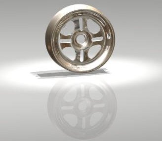

Open PhotoWorks Items in the
Task Pane, select the Appearances
folder, and drag polished steel.
Click .
In the PhotoWorks Studio, select
Infinite White Floor and Rendering Quality of Medium.
The scene:
Depicts a spherical environment sized to complement
the model.
Includes a photographer's studio as background.
Sets up a lighting scheme automatically.
Sets rendering quality, which in turn sets anti-aliasing
quality, the number of reflections and refractions, indirect illumination,
and shadow control. The first rendering is an opportunity to test various
settings (such as environment and lighting) at a lower quality, which
takes less time.
In the PhotoWorks Scene Editor,
on the Room tab, select Porcelain
for the Floor and make it Visible.
In PhotoWorks Options, on the
Document Properties tab, set Anti-aliasing quality to High.
High anti-aliasing quality takes more time but
results in sharper images. This setting is often left until the final
rendering.
Properties set in dialog boxes such as Scene
Editor and Options would
be reset if you returned to the studio.
