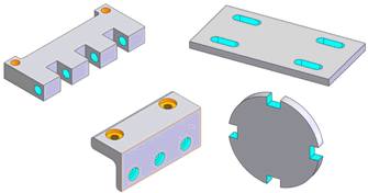

Pattern
A group of DimXpert features having the same type (hole, slot, notch, etc.) and size parameters.
They are generally associated with common dimensions and tolerances. For example, applying a diameter dimension and geometric position tolerance to a pattern of holes.
  • Chamfer
  • Counterbore hole
  • Countersink hole
  • Cylinder
  • Fillet
  • Notch
  • Simple Hole
  • Slot
Simple hole, counterbore, slot, and notch pattern features
Linked Pattern
A DimXpert pattern that is based on and maintains an association with a SW modeling feature or features.
DimXpert pattern features linked to modeling features update automatically if you change the modeling features.
Linked patterns are identified in the DimXpertManager by the link icon .
Slot Pattern1 is a linked pattern and Slot Pattern2 is not.
