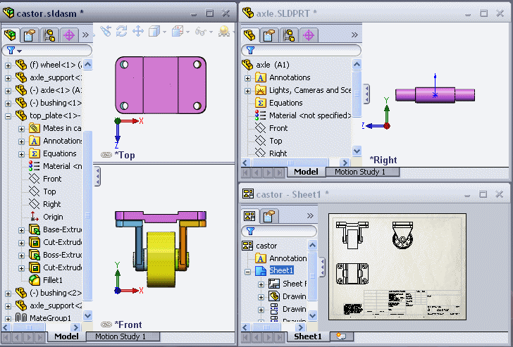

In the SolidWorks application, each part, assembly, and drawing is referred to as a document, and each document is displayed in a separate window. (Each drawing document can contain multiple drawing sheets, though.)
  • The main section of the window, where the model or drawing is displayed, is the graphics area.
  • The left panel displays the FeatureManager design tree, the PropertyManager, the ConfigurationManager, and the DimXpertManager.
  • You can have multiple part, assembly, and drawing document windows open at the same time. Also, you can have multiple views of the same document visible at the same time with New Window or with viewports.
  • To gain as much space as possible in the graphics area, use the Full Screen Mode, which hides the menus, status bar, Task Pane, and FeatureManager design tree area. You can toggle visibility of all open toolbars and the FeatureManager design tree area separately.
