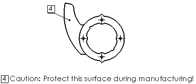

You can apply borders to portions of notes. When inserting or editing a note, select any portion of the note and select a border in the Note PropertyManager.
Three new borders are also supported: square, circle in square, and inspection.
