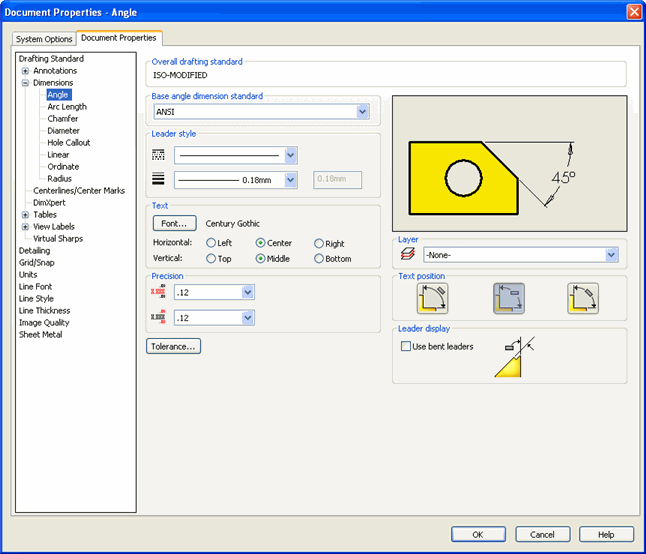

Document Properties > Dimensions > Angle
Setting
Get/Set Methods
Return Value or <Value>
Comments
Base angle dimension standard
IModelDocExtension::GetUserPreferenceInteger(swUserPreferenceIntegerValue_e.swDetailingDimensionStandard, swUserPreferenceOption_e.swDetailingAngleDimension)
IModelDocExtension::SetUserPreferenceInteger(swUserPreferenceIntegerValue_e.swDetailingDimensionStandard, swUserPreferenceOption_e.swDetailingAngleDimension, swDetailingStandard_e.<Value>)
See swDetailingStandard_e for valid options
Specifies the base angle dimensioning standard to use
Leader style - Leader Style
IModelDocExtension::GetUserPreferenceInteger(swUserPreferenceIntegerValue_e.swLineFontDimensionsStyle, swUserPreferenceOption_e.swDetailingAngleDimension)
IModelDocExtension::SetUserPreferenceInteger(swUserPreferenceIntegerValue_e.swLineFontDimensionsStyle, swUserPreferenceOption_e.swDetailingAngleDimension, swLineStyles_e.<Value>)
See swLineStyles_e for valid options
Specifies style of lines for angle dimensions
Leader style - Leader Thickness
IModelDocExtension::GetUserPreferenceInteger(swUserPreferenceIntegerValue_e.swLineFontDimensionsThickness, swUserPreferenceOption_e.swDetailingAngleDimension)
IModelDocExtension::SetUserPreferenceInteger(swUserPreferenceIntegerValue_e.swLineFontDimensionsThickness, swUserPreferenceOption_e.swDetailingAngleDimension, swLineWeights_e.<Value>)
See swLineWeights_e for valid options
Specifies thickness of lines for angle dimensions
Leader style - Custom thickness
IModelDocExtension::GetUserPreferenceDouble(swUserPreferenceDoubleValue_e.swLineFontDimensionsThicknessCustom, swUserPreferenceOption_e.swDetailingAngleDimension)
IModelDocExtension::SetUserPreferenceDouble(swUserPreferenceDoubleValue_e.swLineFontDimensionsThicknessCustom, swUserPreferenceOption_e.swDetailingAngleDimension, <Value>)
Double value
Specifies a custom thickness for lines in angle dimensions; sets Custom Thickness to the specified thickness and Leader Thickness to Custom Size
Text - Font...
IModelDocExtension::GetUserPreferenceTextFormat(swUserPreferenceTextFormat_e.swDetailingDimensionTextFormat, swUserPreferenceOption_e.swDetailingAngleDimension)
IModelDocExtension::SetUserPreferenceTextFormat(swUserPreferenceTextFormat_e.swDetailingDimensionTextFormat, swUserPreferenceOption_e.swDetailingAngleDimension, <Value>)
See ITextFormat for font options
To set font property values, implement ITextFormat, set the appropriate ITextFormat member values, and pass the ITextFormat object in the API set method
Text - Horizontal
IModelDocExtension::GetUserPreferenceInteger(swUserPreferenceIntegerValue_e.swDetailingDimensionTextAlignmentHorizontal, swUserPreferenceOption_e.swDetailingAngleDimension)
IModelDocExtension::SetUserPreferenceInteger(swUserPreferenceIntegerValue_e.swDetailingDimensionTextAlignmentHorizontal, swUserPreferenceOption_e.swDetailingAngleDimension, swTextJustification_e.<Value>)
See swTextJustification_e for valid options
Text - Vertical
IModelDocExtension::GetUserPreferenceInteger(swUserPreferenceIntegerValue_e.swDetailingDimensionTextAlignmentVertical, swUserPreferenceOption_e.swDetailingAngleDimension)
IModelDocExtension::SetUserPreferenceInteger(swUserPreferenceIntegerValue_e.swDetailingDimensionTextAlignmentVertical, swUserPreferenceOption_e.swDetailingAngleDimension, swTextAlignmentVertical_e.<Value>)
See swTextAlignmentVertical_e for valid options
Precision - Unit Precision
IModelDocExtension::GetUserPreferenceInteger(swUserPreferenceIntegerValue_e.swDetailingAngularDimPrecision, swUserPreferenceOption_e.swDetailingAngleDimension)
IModelDocExtension::SetUserPreferenceInteger(swUserPreferenceIntegerValue_e.swDetailingAngularDimPrecision, swUserPreferenceOption_e.swDetailingAngleDimension, <Value>)
Number of decimal places to display; 0 through 8
Specifies integer value for angular precision
Precision - Tolerance Precision
IModelDocExtension::GetUserPreferenceInteger(swUserPreferenceIntegerValue_e.swDetailingAngularTolPrecision, swUserPreferenceOption_e.swDetailingAngleDimension)
IModelDocExtension::SetUserPreferenceInteger(swUserPreferenceIntegerValue_e.swDetailingAngularTolPrecision, swUserPreferenceOption_e.swDetailingAngleDimension, swDimensionPrecisionSettings_e .<Value>)
See swDimensionPrecisionSettings_e for valid options
Specifies integer value for tolerance precision
Tolerance...
See Comments
See Comments
See Dimension Tolerance
Layer
IModelDocExtension::GetUserPreferenceString(swUserPreferenceStringValue_e.swDetailingLayer, swUserPreferenceOption_e.swDetailingAngleDimension)
IModelDocExtension::SetUserPreferenceString(swUserPreferenceStringValue_e.swDetailingLayer, swUserPreferenceOption_e.swDetailingAngleDimension, <Value>)
Valid Options:
  • "Border"
  • "Dimensions"
  • "Notes"
  • "BOM"
  • "FORMAT"
This setting is available only on drawings; depending on drawing, some options may not apply
Text position
IModelDocExtension::GetUserPreferenceInteger(swUserPreferenceIntegerValue_e.swDetailingDimensionTextAndLeaderStyle, swUserPreferenceOption_e.swDetailingAngleDimension)
IModelDocExtension::SetUserPreferenceInteger(swUserPreferenceIntegerValue_e.swDetailingDimensionTextAndLeaderStyle, swUserPreferenceOption_e.swDetailingAngleDimension, swDisplayDimensionLeaderText_e.<Value>)
See swDisplayDimensionLeaderText_e for valid options
Leader display - Use bent leaders
IModelDocExtension::GetUserPreferenceToggle(swUserPreferenceToggle_e.swDetailingDimANSIBentLeader, swUserPreferenceOption_e.swDetailingAngleDimension)
IModelDocExtension::SetUserPreferenceToggle(swUserPreferenceToggle_e.swDetailingDimANSIBentLeader, swUserPreferenceOption_e.swDetailingAngleDimension, <Value>)
Boolean value
Specifies whether to use bent leaders only if detailing standard is ANSI
