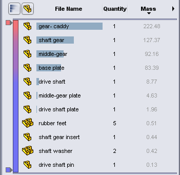

Sorting a Single-Property List
You can rank components based on the values of their custom properties.
The Assembly Visualization tab in the FeatureManager design tree panel contains a list of all components in the assembly, sorted initially by file name.
To sort the list:
  1. Click a column header to sort the components by that property. For example, to sort by component mass, click Mass.
  2. Click again to sort in reverse order.
    You can adjust the width of a column to fit the column contents by double-clicking the column separator.
