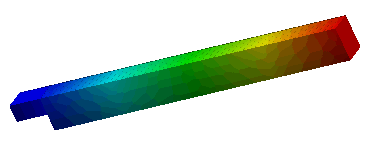

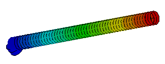

Beam mesh and result plots can now be shown on actual beam geometry. eDrawings supports the new plots.
In previous releases, mesh and result plots for beam studies were displayed on cylinders and not the actual beam geometry. You now have the option to display the results either on cylinders or on the beam geometry.
| Previous releases of SolidWorks Simulation |
SolidWorks Simulation 2012 |
