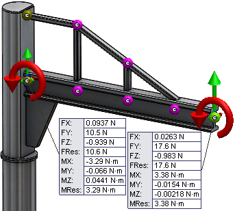

You can list the reaction forces and reaction moments at beam joints that have fixed translations or rotations.
In the Result Force PropertyManager, under Selection, select the beam joint to list the reaction forces.
