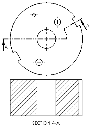

Inserting a Section View with an Arc Offset
To insert a section view with an arc offset:
  1. Open install_dir\samples\whatsnew\drawings\sectionview3.slddrw.

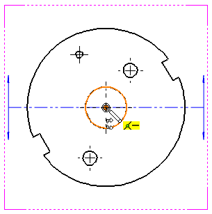

  6. Click sectionxpert-arc-offset.png to add an arc offset.
  7. Move the pointer sectionxpert-pointer.png to the location as shown and click to select the first point of the arc.

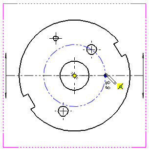

    This point must be on the cutting line.

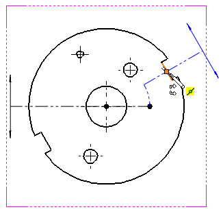

  8. Move the pointer to the location as shown and click to select the second point of the arc.
  9. Click sectionxpert-ok.png to close the Section View popup.
  10. Drag the preview to the location as shown and click to place the section view.
