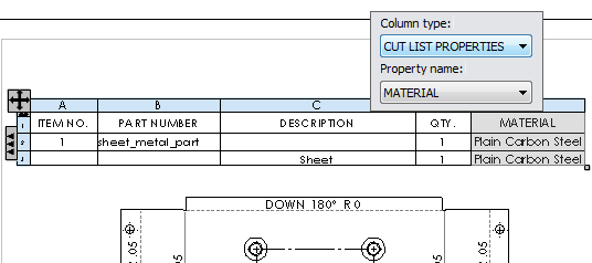

Linking a Cut List Property to a BOM Table Column
To link a cut list property to a BOM table column:
  1. In the BOM table, select the column.
  2. In the popup toolbar, click Column Property.
  3. In Column type, select CUT LIST PROPERTIES.
  4. In Property name, select a cut list property to link to the column.
  5. Click outside the BOM table.
