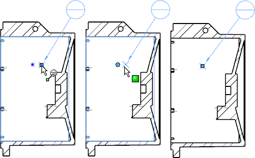

You can dimension and inference datum targets to specific points.
You can use vertex inferences in both drawing and sketch environments to place datum targets.
Drawing_datum_targets_inferencing1
