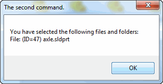

  20. Right-click inside a vault view in Windows Explorer. First command appears in the context-sensitive menu.
  21. Right-click a file in the vault view and click Second command. The add-in displays a dialog similar to the following:
