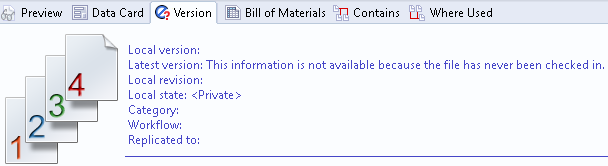

  • The Data card, Bill of Materials, Contains, and Where Used tabs display the message,
  • The Version tab displays:
