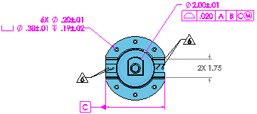

You can control how annotations are displayed when you rotate models.
When you activate Dynamic Annotation Views, you see only the annotation views that are relevant to the current model orientation. As you rotate the model, annotation views that are not normal to the model orientation fade away, while annotations appear as they approach normal.
Annotation views are automatically set as the active view when they are displayed using Dynamic Annotation Views.
