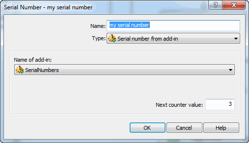

  7. Right-click the Serial Numbers node in the tree and click New Serial Number.
  8. Create a new serial number in the Name field and select Serial number from add-in in the Type dropdown.
    The name of your add-in is displayed in Name of add-in.
  9. After ensuring that your add-in is selected, click OK.

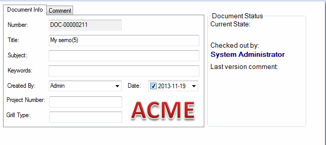

  14. Create a new text file by right-clicking in a Windows Explorer vault view and clicking New > Text File.
    The file data card displays a serial number in Title of the newly added file.
