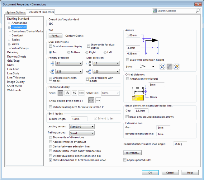

Document Properties > Dimensions
Setting
Get/Set Methods
Return Value or <Value>
Comments
Text - Font...
IModelDocExtension::GetUserPreferenceTextFormat(swUserPreferenceTextFormat_e.swDetailingDimensionTextFormat, swUserPreferenceOption_e.swDetailingDimension)
IModelDocExtension::SetUserPreferenceTextFormat(swUserPreferenceTextFormat_e.swDetailingDimensionTextFormat, swUserPreferenceOption_e.swDetailingDimension, <Value>)
See ITextFormat for font options
To set font property values, implement ITextFormat, set the appropriate ITextFormat member values, and pass the ITextFormat object in the API set method
Dual dimensions - Dual dimensions display
IModelDocExtension::GetUserPreferenceToggle(swUserPreferenceToggle_e.swDetailingDualDimensions, swUserPreferenceOption_e.swDetailingDimension)
IModelDocExtension::SetUserPreferenceToggle(swUserPreferenceToggle_e.swDetailingDualDimensions, swUserPreferenceOption_e.swDetailingDimension, <Value>)
Boolean value
Specifies whether to display dimensions in two kinds of units
Dual dimensions - Show units for dual display
IModelDocExtension::GetUserPreferenceToggle(swUserPreferenceToggle_e.swDetailingShowUnitsForDualDisplay, swUserPreferenceOption_e.swDetailingDimension)
IModelDocExtension::SetUserPreferenceToggle(swUserPreferenceToggle_e.swDetailingShowUnitsForDualDisplay, swUserPreferenceOption_e.swDetailingDimension, <Value>)
Boolean value
Specifies whether to display units for dual dimensions
Dual dimensions - Dimension Position
IModelDocExtension::GetUserPreferenceInteger(swUserPreferenceIntegerValue_e.swDetailingDualDimPosition, swUserPreferenceOption_e.swDetailingDimension)
IModelDocExtension::SetUserPreferenceInteger(swUserPreferenceIntegerValue_e.swDetailingDualDimPosition, swUserPreferenceOption_e.swDetailingDimension, swDetailingDualDimPosition_e.<Value>)
See swDetailingDualDimPosition_e for valid options
Positions the display of dimensions in two kinds of units
Primary precision - Unit Precision
IModelDocExtension::GetUserPreferenceInteger(swUserPreferenceIntegerValue_e.swDetailingLinearDimPrecision, swUserPreferenceOption_e.swDetailingDimension)
IModelDocExtension::SetUserPreferenceInteger(swUserPreferenceIntegerValue_e.swDetailingLinearDimPrecision, swUserPreferenceOption_e.swDetailingDimension, <Value>)
Number of decimal places to display; 0 through 8
Specifies primary precision for linear dimension
Primary precision - Tolerance Precision
IModelDocExtension::GetUserPreferenceInteger(swUserPreferenceIntegerValue_e.swDetailingLinearTolPrecision, swUserPreferenceOption_e.swDetailingDimension)
IModelDocExtension::SetUserPreferenceInteger(swUserPreferenceIntegerValue_e.swDetailingLinearTolPrecision, swUserPreferenceOption_e.swDetailingDimension, swDimensionPrecisionSettings_e .<Value>)
See swDimensionPrecisionSettings_e for valid options
Specifies primary precision for linear tolerance
Primary precision - Link precisions with model
IModelDocExtension::GetUserPreferenceToggle(swUserPreferenceToggle_e.swDetailingLinearDimPrecisionLinkWithModel, swUserPreferenceOption_e.swDetailingDimension)
IModelDocExtension::SetUserPreferenceToggle(swUserPreferenceToggle_e.swDetailingLinearDimPrecisionLinkWithModel, swUserPreferenceOption_e.swDetailingDimension, <Value>)
Boolean value
Dual precision - Unit Precision
IModelDocExtension::GetUserPreferenceInteger(swUserPreferenceIntegerValue_e.swDetailingAltLinearDimPrecision, swUserPreferenceOption_e.swDetailingDimension)
IModelDocExtension::SetUserPreferenceInteger(swUserPreferenceIntegerValue_e.swDetailingAltLinearDimPrecision, swUserPreferenceOption_e.swDetailingDimension, <Value>)
Specifies dual precision for alternate linear dimension
Dual precision - Tolerance Precision
IModelDocExtension::GetUserPreferenceInteger(swUserPreferenceIntegerValue_e.swDetailingAltLinearTolPrecision, swUserPreferenceOption_e.swDetailingDimension)
IModelDocExtension::SetUserPreferenceInteger(swUserPreferenceIntegerValue_e.swDetailingAltLinearTolPrecision, swUserPreferenceOption_e.swDetailingDimension, swDimensionPrecisionSettings_e .<Value>)
Specifies dual precision for alternate linear tolerance
Dual precision - Link precisions with model
IModelDocExtension::GetUserPreferenceToggle(swUserPreferenceToggle_e.swDetailingAltLinearDimPrecisionLinkWithModel, swUserPreferenceOption_e.swDetailingDimension)
IModelDocExtension::SetUserPreferenceToggle(swUserPreferenceToggle_e.swDetailingAltLinearDimPrecisionLinkWithModel, swUserPreferenceOption_e.swDetailingDimension, <Value>)
Boolean value
Fractional display - Style
IModelDocExtension::GetUserPreferenceInteger(swUserPreferenceIntegerValue_e.swDetailingDimFractionStyle, swUserPreferenceOption_e.swDetailingNoOptionSpecified)
IModelDocExtension::SetUserPreferenceInteger(swUserPreferenceIntegerValue_e.swDetailingDimFractionStyle, swUserPreferenceOption_e.swDetailingNoOptionSpecified, swDetailingDimFractionStyle_e.<Value>)
See swDetailingDimFractionStyle_e for valid options
Fractional display - Stack size
IModelDocExtension::GetUserPreferenceInteger(swUserPreferenceIntegerValue_e.swDetailingDimFractionScaleIndex, swUserPreferenceOption_e.swDetailingNoOptionSpecified)
IModelDocExtension::SetUserPreferenceInteger(swUserPreferenceIntegerValue_e.swDetailingDimFractionScaleIndex, swUserPreferenceOption_e.swDetailingNoOptionSpecified, swDetailingDimFractionScaleIndex_e.<Value>)
See swDetailingDimFractionScaleIndex_e for valid options
Fractional display - Show double prime mark('')
IModelDocExtension::GetUserPreferenceToggle(swUserPreferenceToggle_e.swDoublePrimeMark, swUserPreferenceOption_e.swDetailingNoOptionSpecified)
IModelDocExtension::SetUserPreferenceToggle(swUserPreferenceToggle_e.swDoublePrimeMark, swUserPreferenceOption_e.swDetailingNoOptionSpecified, <Value>)
Boolean value
Specifies whether to show the double prime mark ('') in a fractional display
Fractional display - Include leading zero for values less than 1"
IModelDocExtension::GetUserPreferenceToggle(swUserPreferenceToggle_e.swDetailingDimsShowLeadingZeros, swUserPreferenceOption_e.swDetailingNoOptionSpecified)
IModelDocExtension::SetUserPreferenceToggle(swUserPreferenceToggle_e.swDetailingDimsShowLeadingZeros, swUserPreferenceOption_e.swDetailingNoOptionSpecified, <Value>)
Boolean value
Specifies whether to show leading zero for values less than 1" in a fractional display
Bent leaders - Leader length
IModelDocExtension::GetUserPreferenceDouble(swUserPreferenceDoubleValue_e.swDetailingDimBentLeaderLength, swUserPreferenceOption_e.swDetailingNoOptionSpecified)
IModelDocExtension::SetUserPreferenceDouble(swUserPreferenceDoubleValue_e.swDetailingDimBentLeaderLength, swUserPreferenceOption_e.swDetailingNoOptionSpecified, <Value>)
Double value in meters
Specifies bent leader length
Leading zeroes
IModelDocExtension::GetUserPreferenceInteger(swUserPreferenceIntegerValue_e.swDetailingLeadingZero, swUserPreferenceOption_e.swDetailingNoOptionSpecified)
IModelDocExtension::SetUserPreferenceInteger(swUserPreferenceIntegerValue_e.swDetailingLeadingZero, swUserPreferenceOption_e.swDetailingNoOptionSpecified, swDetailingLeadingZero_e.<Value>)
See swDetailingLeadingZero_e for valid options
Trailing zeroes
IModelDocExtension::GetUserPreferenceInteger(swUserPreferenceIntegerValue_e.swDetailingDimTrailingZero, swUserPreferenceOption_e.swDetailingNoOptionSpecified)
IModelDocExtension::SetUserPreferenceInteger(swUserPreferenceIntegerValue_e.swDetailingDimTrailingZero, swUserPreferenceOption_e.swDetailingNoOptionSpecified, swDetailingDimTrailingZero_e.<Value>)
See swDetailingDimTrailingZero_e for valid options
Show units of dimensions
IModelDocExtension::GetUserPreferenceToggle(swUserPreferenceToggle_e.swDetailingShowDimensionUnits, swUserPreferenceOption_e.swDetailingNoOptionSpecified)
IModelDocExtension::SetUserPreferenceToggle(swUserPreferenceToggle_e.swDetailingShowDimensionUnits, swUserPreferenceOption_e.swDetailingNoOptionSpecified, <Value>)
Boolean value
Specifies whether to show dimension units
Add parentheses by default
IModelDocExtension::GetUserPreferenceToggle(swUserPreferenceToggle_e.swDetailingDimsShowParenthesisByDefault, swUserPreferenceOption_e.swDetailingNoOptionSpecified)
IModelDocExtension::SetUserPreferenceToggle(swUserPreferenceToggle_e.swDetailingDimsShowParenthesisByDefault, swUserPreferenceOption_e.swDetailingNoOptionSpecified, <Value>)
Boolean value
Specifies whether to show reference dimensions within parentheses in drawings
Center between extension lines
IModelDocExtension::GetUserPreferenceToggle(swUserPreferenceToggle_e.swDetailingDimsCenterText, swUserPreferenceOption_e.swDetailingNoOptionSpecified)
IModelDocExtension::SetUserPreferenceToggle(swUserPreferenceToggle_e.swDetailingDimsCenterText, swUserPreferenceOption_e.swDetailingNoOptionSpecified, <Value>)
Boolean value
Specifies whether to center dimension text between extension lines
Include prefix inside basic tolerance box
IModelDocExtension::GetUserPreferenceToggle(swUserPreferenceToggle_e.swDetailingDimsPrefixInsideBasicTolBox, swUserPreferenceOption_e.swDetailingNoOptionSpecified)
IModelDocExtension::SetUserPreferenceToggle(swUserPreferenceToggle_e.swDetailingDimsPrefixInsideBasicTolBox, swUserPreferenceOption_e.swDetailingNoOptionSpecified, <Value>)
Boolean value
Specifies whether to include prefix inside basic tolerance box
Display dual basic dimension in one box
IModelDocExtension::GetUserPreferenceToggle(swUserPreferenceToggle_e.swDetailingDisplayDualBasicDimensionInOneBox, swUserPreferenceOption_e.swDetailingNoOptionSpecified)
IModelDocExtension::SetUserPreferenceToggle(swUserPreferenceToggle_e.swDetailingDisplayDualBasicDimensionInOneBox, swUserPreferenceOption_e.swDetailingNoOptionSpecified, <Value>)
Boolean value
Specifies whether to display dual basic dimensions in one box
Show dimensions as broken in broken views
IModelDocExtension::GetUserPreferenceToggle(swUserPreferenceToggle_e.swDetailingDimsShowBroken, swUserPreferenceOption_e.swDetailingNoOptionSpecified)
IModelDocExtension::SetUserPreferenceToggle(swUserPreferenceToggle_e.swDetailingDimsShowBroken, swUserPreferenceOption_e.swDetailingNoOptionSpecified, <Value>)
Boolean value
Specifies whether to show dimensions as broken in broken views
Apply updated rules
IModelDocExtension::GetUserPreferenceToggle(swUserPreferenceToggle_e.swDetailingDimsApplyUpdatedRules, swUserPreferenceOption_e.swDetailingNoOptionSpecified)
IModelDocExtension::SetUserPreferenceToggle(swUserPreferenceToggle_e.swDetailingDimsApplyUpdatedRules, swUserPreferenceOption_e.swDetailingNoOptionSpecified, <Value>)
Boolean value
Specifies whether to apply updated rules
Radial/Diameter leader snap angle
IModelDocExtension::GetUserPreferenceDouble(swUserPreferenceDoubleValue_e.swDetailingDimRadialSnapAngle, swUserPreferenceOption_e.swDetailingNoOptionSpecified)
IModelDocExtension::SetUserPreferenceDouble(swUserPreferenceDoubleValue_e.swDetailingDimRadialSnapAngle, swUserPreferenceOption_e.swDetailingNoOptionSpecified, <Value>)
Double value between 0 and 90
Specifies radial leader snap angle.
Tolerance...
See Comments
See Comments
See Dimension Tolerance
Arrows - Width
IModelDocExtension::GetUserPreferenceDouble(swUserPreferenceDoubleValue_e.swDetailingArrowWidth, swUserPreferenceOption_e.swDetailingNoOptionSpecified)
IModelDocExtension::SetUserPreferenceDouble(swUserPreferenceDoubleValue_e.swDetailingArrowWidth, swUserPreferenceOption_e.swDetailingNoOptionSpecified, <Value>)
Specifies width of arrowheads
Arrows - Height
IModelDocExtension::GetUserPreferenceDouble(swUserPreferenceDoubleValue_e.swDetailingArrowHeight, swUserPreferenceOption_e.swDetailingNoOptionSpecified)
IModelDocExtension::SetUserPreferenceDouble(swUserPreferenceDoubleValue_e.swDetailingArrowHeight, swUserPreferenceOption_e.swDetailingNoOptionSpecified, <Value>)
Specifies length of arrowheads
Arrows - Length
IModelDocExtension::GetUserPreferenceDouble(swUserPreferenceDoubleValue_e.swDetailingArrowLength, swUserPreferenceOption_e.swDetailingNoOptionSpecified)
IModelDocExtension::SetUserPreferenceDouble(swUserPreferenceDoubleValue_e.swDetailingArrowLength, swUserPreferenceOption_e.swDetailingNoOptionSpecified, <Value>)
Specifies length of arrows
Arrows - Scale with dimension height
IModelDocExtension::GetUserPreferenceToggle(swUserPreferenceToggle_e.swDetailingScaleWithDimHeight, swUserPreferenceOption_e.swDetailingNoOptionSpecified)
IModelDocExtension::SetUserPreferenceToggle(swUserPreferenceToggle_e.swDetailingScaleWithDimHeight, swUserPreferenceOption_e.swDetailingNoOptionSpecified, <Value>)
Boolean value
Specifies whether to scale the arrow head to the height of the dimension text
Arrows - Style
IModelDocExtension::GetUserPreferenceInteger(swUserPreferenceIntegerValue_e.swDetailingArrowStyleForDimensions, swUserPreferenceOption_e.swDetailingNoOptionSpecified)
IModelDocExtension::SetUserPreferenceInteger(swUserPreferenceIntegerValue_e.swDetailingArrowStyleForDimensions, swUserPreferenceOption_e.swDetailingNoOptionSpecified, swArrowStyle_e.<Value>)
See swArrowStyle_e for valid options
Specifies the default style of dimension arrows
Arrows - Position
IModelDocExtension::GetUserPreferenceInteger(swUserPreferenceIntegerValue_e.swDetailingDimensionArrowPosition, swUserPreferenceOption_e.swDetailingNoOptionSpecified)
IModelDocExtension::SetUserPreferenceInteger(swUserPreferenceIntegerValue_e.swDetailingDimensionArrowPosition, swUserPreferenceOption_e.swDetailingNoOptionSpecified, swDimensionArrowsSide_e.<Value>)
See swDimensionArrowsSide_e for valid options
Specifies position of arrows
Offset distances - Annotation view layout
See Comments
See Comments
Not currently available in SOLIDWORKS API
Offset distances - Dimension to dimension offset
IModelDocExtension::GetUserPreferenceDouble(swUserPreferenceDoubleValue_e.swDetailingDimToDimOffset, swUserPreferenceOption_e.swDetailingNoOptionSpecified)
IModelDocExtension::SetUserPreferenceDouble(swUserPreferenceDoubleValue_e.swDetailingDimToDimOffset, swUserPreferenceOption_e.swDetailingNoOptionSpecified, <Value>)
Specifies distance between dimension lines for baseline dimensions and Align Parallel/Concentric; offset distance for dimensions displayed with tolerances automatically doubled
Offset distances - Object to dimension offset
IModelDocExtension::GetUserPreferenceDouble(swUserPreferenceDoubleValue_e.swDetailingObjectToDimOffset, swUserPreferenceOption_e.swDetailingNoOptionSpecified)
IModelDocExtension::SetUserPreferenceDouble(swUserPreferenceDoubleValue_e.swDetailingObjectToDimOffset, swUserPreferenceOption_e.swDetailingNoOptionSpecified, <Value>)
Specifies distance between model and first dimension for baseline dimensions but not for Align Parallel/Concentric
Break dimension extension/leader lines - Gap
IModelDocExtension::GetUserPreferenceDouble(swUserPreferenceDoubleValue_e.swDetailingDimBreakGap, swUserPreferenceOption_e.swDetailingNoOptionSpecified)
IModelDocExtension::SetUserPreferenceDouble(swUserPreferenceDoubleValue_e.swDetailingDimBreakGap, swUserPreferenceOption_e.swDetailingNoOptionSpecified, <Value>)
For drawings only; Specifies dimension's gap in extension and leader lines when they are broken
Break dimension extension/leader lines - Break only around dimension arrows
IModelDocExtension::GetUserPreferenceToggle(swUserPreferenceToggle_e.swDetailingDimBreakAroundArrow, swUserPreferenceOption_e.swDetailingNoOptionSpecified)
IModelDocExtension::SetUserPreferenceToggle(swUserPreferenceToggle_e.swDetailingDimBreakAroundArrow, swUserPreferenceOption_e.swDetailingNoOptionSpecified, <Value>)
Boolean value
For drawings only; Specifies whether to have breaks occur only where lines cross arrow
Extension lines - Gap
IModelDocExtension::GetUserPreferenceDouble(swUserPreferenceDoubleValue_e.swDetailingWitnessLineGap, swUserPreferenceOption_e.swDetailingNoOptionSpecified)
IModelDocExtension::SetUserPreferenceDouble(swUserPreferenceDoubleValue_e.swDetailingWitnessLineGap, swUserPreferenceOption_e.swDetailingNoOptionSpecified, <Value>)
For drawings only; Specifies the distance between the model and dimension extension lines
Extension lines - Beyond dimension line
IModelDocExtension::GetUserPreferenceDouble(swUserPreferenceDoubleValue_e.swDetailingWitnessLineExtension, swUserPreferenceOption_e.swDetailingNoOptionSpecified)
IModelDocExtension::SetUserPreferenceDouble(swUserPreferenceDoubleValue_e.swDetailingWitnessLineExtension, swUserPreferenceOption_e.swDetailingNoOptionSpecified, <Value>)
For drawings only; Specifies length of the extension line beyond dimension line
Page:   Document Properties > Dimensions
