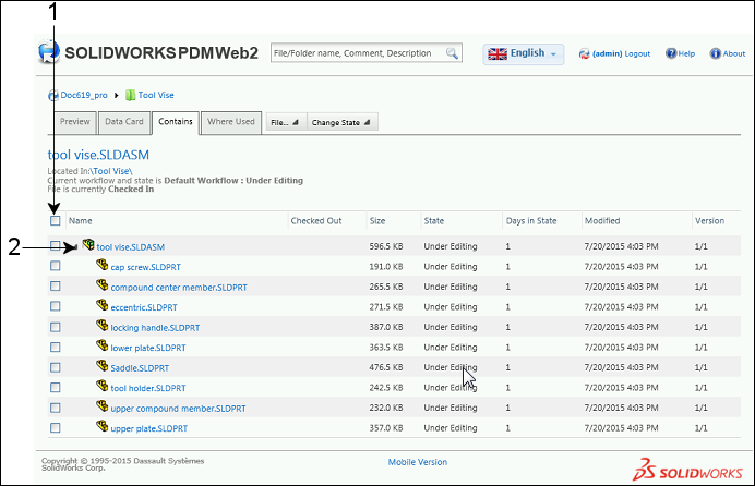

The Contains page lists the files that are referenced by the selected file.
To display the Contains page, do one of the following:
- Click the file name link and select the Contains tab.
- Hover over a file name, expand the arrow, and select Contains.
Contains Tab
| 1 |
Check boxes
Let you select a file to perform operations like check out, undo check out, download, delete, and change state. The check box next to Name lets you select or clear a file structure.
| 2 |
Expand or Collapse control
The arrow next to the check box lets you
expand or collapse a file structure. |
