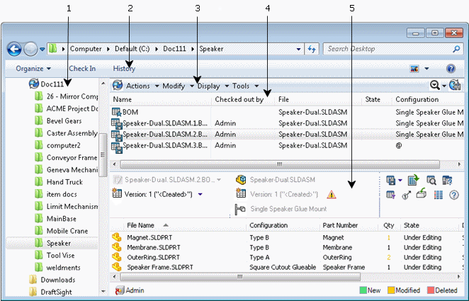

BOM view lists the activated and named BOMs in the current folder and lets you view and modify their details.
BOMView2
1 Navigation pane Lets you browse vaults and folders.
2 Windows Explorer toolbar Contains commands that apply to the selected file or folder.
When you are logged in to vault, the Help button Get_help.gif on the Windows Explorer toolbar opens the SOLIDWORKS PDM File Explorer help.
3 SOLIDWORKS PDM menu bar Contains menus of commands that can be performed for the selected file or folder.
4 BOM lists Lists the named and activated BOMs in the current folder.
5 BOM contents Displays the details of the BOM, which depend on the type of BOM you are viewing.
