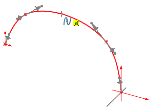

  1. In Edit Sketch mode, right-click a spline and select Insert Spline Point, or click Insert Spline Point Tool_Insert_Spline_Point_Spline_Tools.gif (Spline Tools toolbar).
    The pointer changes to Pointer_Insert_Spline_Point02.gif. If the pointer is not on the spline, the pointer changes to Pointer_Insert_Spline_Point01.gif.
  2. Click one or more places on the spline where you want to insert a point.
