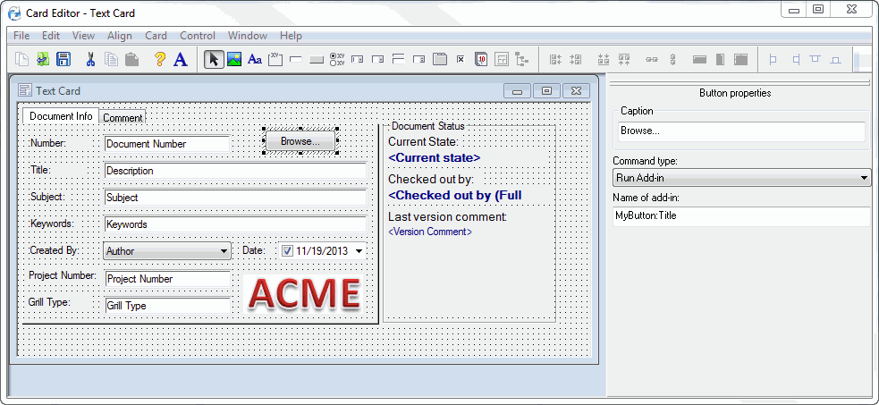

  8. Click Cards > File Cards.
  9. Double-click Text Card.
  10. Add a button to the card.
  11. Click the button.
  12. In Caption, type Browse....
  13. In Command type, select Run Add-in.
  14. In Name of add-in, type MyButton:Title.
  15. Save the card and exit the Card Editor.
  16. Open Windows Explorer on the vault and select a checked-out text file.
  17. Click Browse in the file's data card.
  18. The Select File for Title dialog box pops up.
  19. Browse to and select the checked-out text file.
  20. Click Open to copy the path of the selected file to the Title field of the file's data card.
