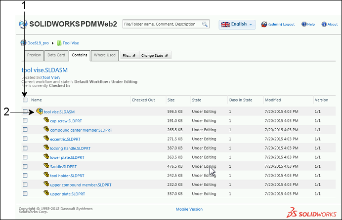

Contains Page
The Contains page lists the files that are referenced by the selected file.
To display the Contains page, do one of the following:
  • Click the file name link and select the Contains tab.
  • Hover over a file name, expand the arrow, and select Contains.
Contains Tab
1 Check boxes Let you select a file to perform operations like check out, undo check out, download, delete, and change state.
The check box next to Name lets you select or clear a file structure.
2 Expand or Collapse control The arrow next to the check box lets you expand or collapse a file structure.
