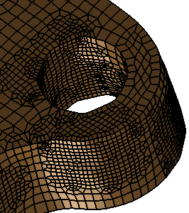

Voxel Creates a solid mesh with square orthogonal hexahedra. The voxel mesh could fail in capturing accurately the geometry of detailed features or high-curvature surfaces.
Marching Creates a mesh with both surface triangle elements and orthogonal hexahedral elements through the volume. The mesh display shows the surface mesh. Create a cross-section to view the hexahedral mesh formulation. The marching mesh captures the geometry of detailed features or curved surfaces more accurately than the voxel mesh.
Non-Orthogonal Voxel Creates a solid mesh with non-orthogonal hexahedra to capture more accurately the shape of the part. The surface mesh should be of good quality (no holes, intersecting elements, or non-manifold elements).
Voxel hexahedral mesh Non-orthogonal hexahedral Voxel mesh Marching mesh with hexahedral and surface triangle elements (cross-section)
