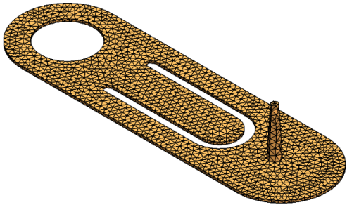

| Shell mesh created with Automatic option. |

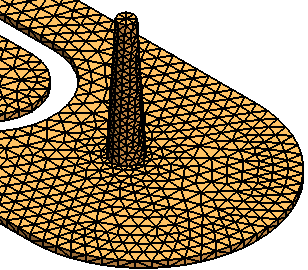

| Shell mesh created with Manual option and Local Refinement set to Automatic. A finer mesh is applied to smaller features. |
