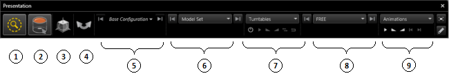

Presentation Toolbar
The Presentation toolbar lets you control the presentation of real-time scenes. It floats on top the existing scene, and fades out when you are not using it. You can toggle the visibility of the Presentation toolbar by pressing the spacebar.
To customize the Presentation toolbar:
  • Drag and drop controls within the toolbar to change their order.
    Drop a control outside of the toolbar to hide it.
  • Toggle the visibility of each control in the Presentation toolbar:
    Expand the Customize Toolbar drop-down menu on the lower right of the toolbar and select or clear the controls.
The Presentation toolbar contains the following controls:
1 Render Mode Displays the control that is currently selected on the main toolbar.
2 Selection Mode Displays the control that is currently selected on the main toolbar.
3 Object Manipulation Tool Displays the control that is currently selected on the main toolbar.
4 Camera Tool Displays the control that is currently selected on the main toolbar.
5 Configurations Lets you select a specific configuration, and switch consecutively between existing configurations (previous, next).
You cannot create new configurations.
6 Model Set Navigator
Lets you select a specific Model Set, and switch consecutively between existing Model Sets (previous, next).
You cannot create a new model set.
7 Turntable Navigator Lets you take the following actions on the selected model or models in the combo box:
  • Enable/Disable
  • Play/Pause
  • Faster/Slower
  • Reverse rotation
  • Reset
8 Camera Navigator Lets you select a specific Camera and switch consecutively between existing Cameras (previous, next).
You cannot create a new camera.
9 Animation Navigator Lets you take the following actions on the current selections in the combo box:
  • Play/Pause
  • Faster/Slower
  • Previous/Next frame
