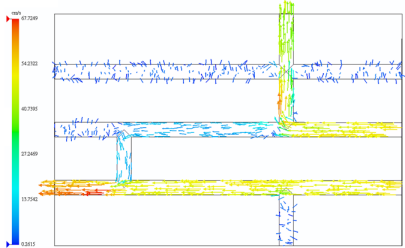

After completion of the Coolant Flow Field analysis, new result plot options are available for coolant velocity and coolant pressure.
Velocity of coolant system |

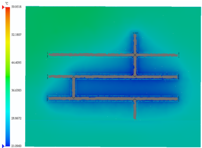

Mold Temperature at end of cooling |
