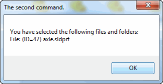

Right-click a file in
the vault view and click Second
command. The add-in displays a dialog similar to the following:
