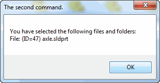

  23. Right-click a file in the vault view and click Second command. The add-in displays a dialog similar to the following:
