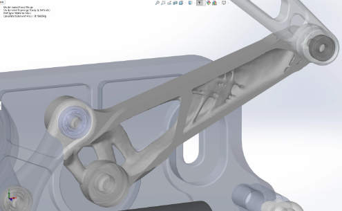

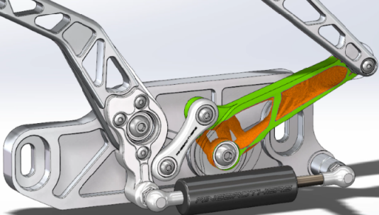

A Material Mass plot of the optimized car hood
component is shown below. The "soft" elements are removed from the optimized geometry
(image courtesy of Ring Brothers LLC).
In the Material Mass PropertyManager, option
Calculate Smoothed Mesh creates a smooth mesh from the active
Material Mass plot. A smoothed mesh plot of the optimized car
hood component is shown below (image courtesy of Ring Brothers LLC).
To save the smoothed mesh of the optimized part as new geometry, right-click
the Material Mass plot, and click Export Smoothed
Mesh. You can save the mesh data in a new configuration, or in a new
part file.
