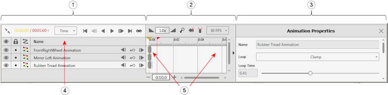

This section describes the animation timeline and controls.
The animation timeline and controls are available only in SOLIDWORKS Visualize Professional.
To display the animation timeline, click .
The controls remain on the screen until you clear or press the spacebar to enter Easy Mode.
The following figure shows the animation timeline and controls.
1 |
Basic animation controls |
2 |
Advanced animation controls |
3 |
Animation Properties |
4 |
Animation list |
5 |
Timeline |
