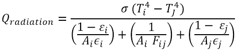

When the two surfaces have different values of emissivity εi and εj, the net radiation heat exchange between the surfaces is given by:
