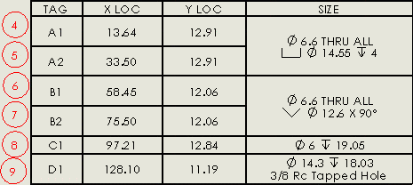

You can extract all information from hole tables. You can capture all information available in drawings, including complex hole tables.
Balloons appear at the side of hole tables. You can adjust their locations with the options in the Add/Edit Balloons menu. You can also hide the balloons.
All information in hole tables is included in the characteristic tree, including the X and Y positions of the holes.
