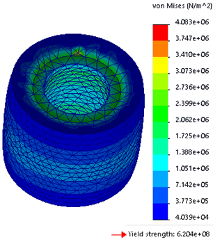

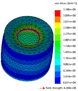

A rigid connection produces stress hot spot areas inside the head and nut regions of the connected components, because rigid bars introduce high stiffnesses. A distributed connection eliminates these high stresses.

Rigid Bolt Connection Distributed Bolt Connection
von Mises stress plot with hot spot at the head imprint region. von Mises stress plot with smoother gradients at the head imprint region.

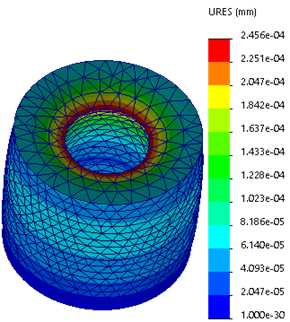

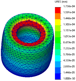

Resultant displacement plot showing uniform deformation at the head imprint region. Resultant displacement plot showing smoother distribution at the head imprint region.
