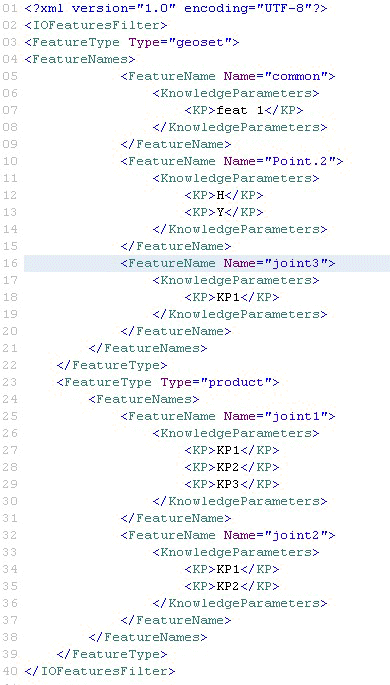

A sample feature file, FeatureFilterNoKnowledge.xml, is located in: < install_dir>\Bin. If you select this file, Composer and Sync do not import any metadata from geoset and product.
In this example, the file is separated in two parts: geometrical set and product.
Composer and Sync import the KP1 knowledge parameter from the joint3 geoset or the feat 1 knowledge parameter from all geosets not described in the XML.
