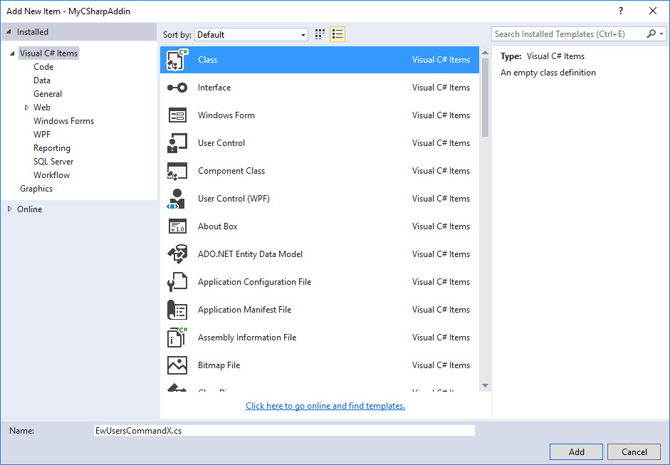

Create C# class with Visual Studio
  • Open your project in Visual Studio
  • Select your project and click on
  • Add -> New Item...
  • Select Visual C# Items -> Class
  • Rename your class here with MyCommandWithRibbonControl
Click OK.
