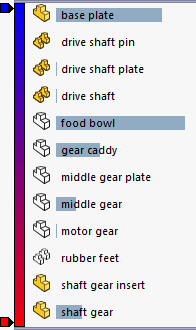

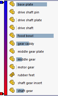

  2. To filter out components that are in the hidden state, click the down arrow and click Filter Hidden Components.
    Components that are in the hidden state disappear from the list. Because those components were already hidden in the graphics area, the graphics area does not change.
    Unfiltered Filtered
    Click the down arrow and clear Filter Hidden Components to return hidden components to the list.
