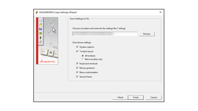

You
can use the Copy Settings Wizard in SOLIDWORKS even if your administrator has locked
options.
If an administrator defines options for you,
the settings in your swSettings.sldreg
file merge with the administrator settings. When settings conflict, the administrator
settings override the individual settings.
To
access the Copy Settings Wizard in SOLIDWORKS, click .
