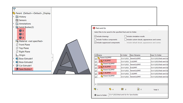

You can include parts that you create with the
Split
and
Save
Bodies features.
When you select a parent part, Pack and Go lists
the
Split
and
Save
Bodies features as references of the parent. Pack and Go also updates
the names and file paths of the parent part and features when you rename and move the
files.
