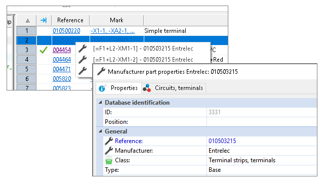

![](inc1610721770336.image)
In BOMs, you can manage links in a merged cell, for example, when
several components use the same manufacturer part.
In a BOM or other reports, the report viewer
displays links. These links display information like the properties, the location in the
drawings of the selected element, or open the drawing and zoom the component. By
clicking the right mouse button on the link, you can select the component you want to
display the information.
