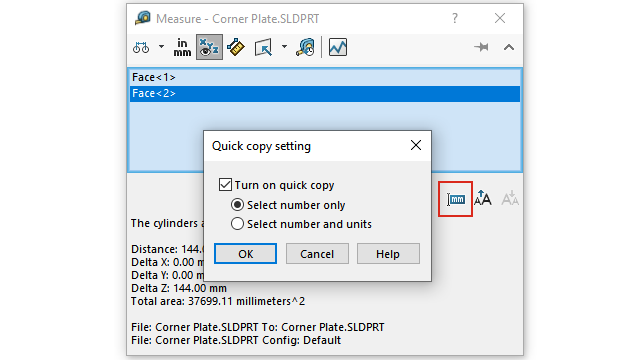

Quick Copy Setting
The Quick Copy Setting functionality in the Measure tool is re-enabled. You can use it to copy a value in the Measure dialog box.
To use Quick Copy Setting:
  1. Click Measure (Tools toolbar).
  2. In the Measure dialog box, click Quick Copy Setting .
  3. In the Quick copy setting dialog box, specify options:
    • Turn on quick copy. Enables the Quick Copy Setting functionality in the Measure dialog box.
    • Select number only. Highlights the numerical value in the measurement text when you hover over it in the Measure dialog box.
    • Select number and units. Highlights the numerical value and units in the measurement text when you hover over it in the Measure dialog box.
  4. Click OK.
    The next time you measure an entity, you can select Click to copy when you hover over a value in the Measure dialog box.
