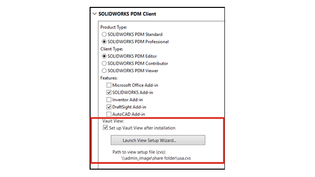

Administrators can
set up a local vault view when creating an administrative image for SOLIDWORKS
Enterprise PDM client users.
A local file vault
view is the local working folder on a client workstation where files are cached and
where a user edits the content of files that are checked out.
This feature lets administrators create a local vault
view without having to create and run a separate script.
To create the vault view on the client machine, you need a Conisio View Setup
(.cvs) file
that
defines the parameters for configuring the vault view on the client
machine. You can reference an existing .cvs file or create this
file from the Administrative Image Option Editor.
