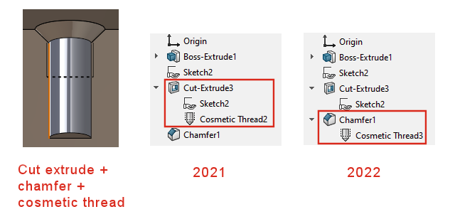

If you use the command, the mirrored part inherits the cosmetic thread behavior
from the base part. For example, if the base part is created in SOLIDWORKS 2021,
the mirrored part inherits the legacy behavior for cosmetic threads from the
base part.
from the original location of an edge regardless of
changes made by downstream features that relocate that edge. In the image above, the
original thread depth is 80 from the edge of the cut extrude. If you add a second cut
extrude that relocates that edge, the cosmetic thread retains the original thread depth
of 80 mm.
