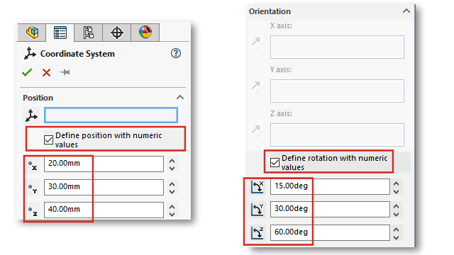

In parts and assemblies, you can define coordinate systems by
entering absolute numeric values for position and orientation.
In the Coordinate System PropertyManager, under Position, select Define position with numeric
values and enter numeric values for the X, Y, and Z coordinates (
, and
). The values define the position relative to the local origin, not the global origin
(0, 0, 0).
To rotate the coordinate system, under
Orientation, select Define
rotation
with numeric values and enter numeric values for at least one axis. The
axes always rotate in the sequence
then
, then
Original |
Position defined |
Position and
rotation defined |
