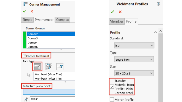

Complex Corner PropertyManager
Improvements in the Complex Corner PropertyManager provide a clear workflow to use the Corner Management functionality.
  • On the Two member tab, under Corner Management, the Miter trim plane point lets you select a point from the graphics area to create the miter trim through the selected point.
  • Options related to Corner Treatment are displayed only if you select the Corner Treatment check box.
  • Icons for planar trim options are smaller than icons for trim type to depict the hierarchy.
  • Transfer Material from Profile transfers the material of the selected library profile if the profile has a material assigned to it.
