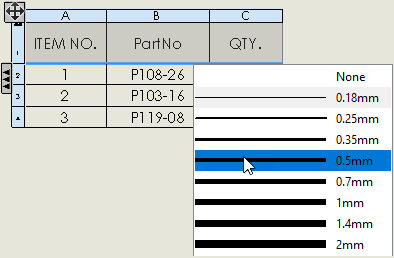

In tables, you can change the border thickness of individual cells,
selected groups of cells, and entire tables. You can also remove cell borders.
To change the cell border thickness:
Select one or more
cells.
![](oar1530018645790.image)
To select cells, you can:
- Click, Ctrl + click, or
Shift + click in cells.
- Click a column letter or a row number.
- Click
to select the entire
table.
On the pop-up toolbar, click Border Edit
The pointer changes to
![](qqz1520882242026.image)
Move the pointer over a border of the selected cells.
![](hyi1520882370212.image)
when it is over a valid border.
![](suy1530018413058.image)
Click one or more borders of the selected cells and select a
new border thickness.
![](pts1530018989799.image)
You can:
- Continue clicking and changing other borders of the selected cells.
- Select None to remove the cell
border.
To turn off Border Edit
, click it on the toolbar or
click in a blank region of the graphics area.
Repeat steps 1 through 4 to change borders on other
cells.
