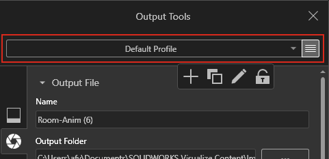

At the top of the Output Tools dialog box, you can
select render profiles in the drop-down list from the Smart Control
Bar. The profiles contain preset options to provide setting presets for
common renderings. You can also create custom profiles and lock them to prevent changes
to the settings.
