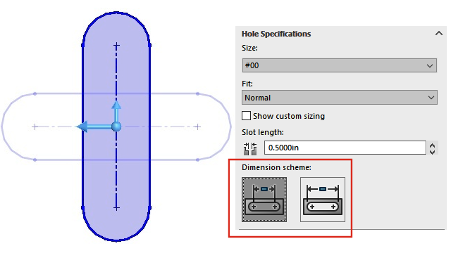

When you create and position Hole Wizard slots, press Tab to rotate the orientation 90°
clockwise.
You can dimension the slot length using the arc centers.
Previously, you could
only drag slots to reposition them and dimension them only with end-to-end
dimensions.
