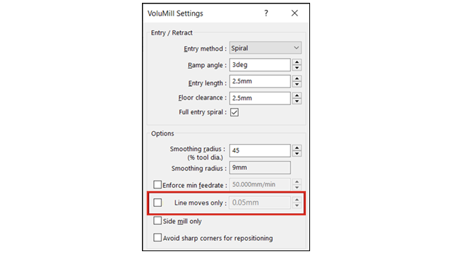

You can split arcs that are larger than 90 degrees into smaller lines using Lines only. This option is available in the VoluMill Settings dialog box in SOLIDWORKS CAM and Technology Database, and applies to 2.5 axis and 3 axis VoluMill toolpaths.
You can specify a deviation for this option. This value splits the arcs into linear moves.
