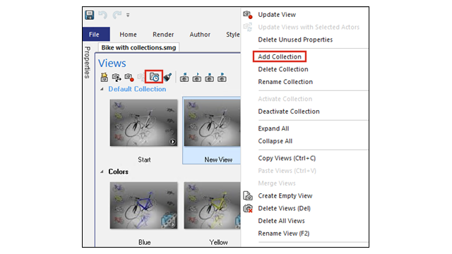

You can manage and organize views into collections in the
Views pane.
You can also:
- Drag views into collections
- Expand or collapse collections
- Rename collections
- Activate or deactivate collections
- Delete collection views
You can create a collection of views in the
Views pane by doing the following:
- In the Views pane, click
Create View Collection
- Right-click a view and select Add
Collection.
See
Composer Help:
Working with
Views >
View Collections and
Working with the
Left Panes > Views Pane.
