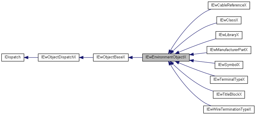

Inheritance diagram for IEwEnvironmentObjectX:

Detailed Description
This interface is a generic interface for environment object methods.
